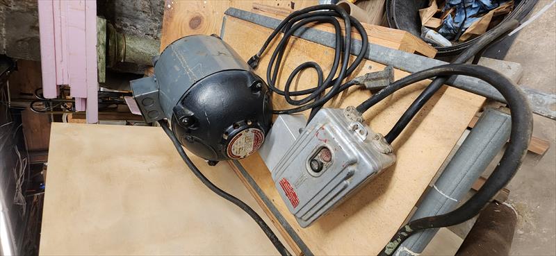

Selling a turnkey, premium vintage motor package removed from a 1953 Rockwell Unisaw. This is the highly sought-after 87M210 model, featuring the proprietary integrated mount designed specifically for the Unisaw's internal tilting mechanism.
?This unit is dual-voltage (220V/440V) and dual-frequency, making it highly versatile. It is in exceptional condition with an excellent history:
?Specs: 1.5 HP, Three-Phase, 1725 RPM (60 Hz) / 1428 RPM (50 Hz).
?Professional Provenance: Completely serviced in the early 1990s by a professional General Electric repulsion-induction motor builder.
?Storage & Care: Ran flawlessly for five years post-service before being prepped and placed into a strictly climate-controlled storage space until now. Freshly detailed and ready for service.
?Plug-and-Play Single-Phase Setup: Includes a vintage Cutler-Hammer motor starter and a CSA-certified Islander Electric "Phase Adder" static phase converter (Model S-1 1/2, Everett, WA). The converter is specifically rated for a single 1.5 HP motor (240V, 8A input / 5A output), allowing you to run this exact setup flawlessly on standard residential power.
?Perfect for a high-end period restoration or an upgrade to an existing cabinet saw.
