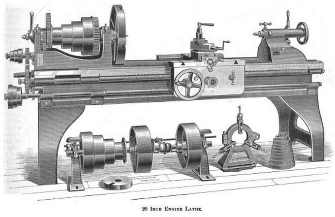

Thomas F. Carver and Michael F. McMahon were operating as McMahon & Carver by 1883. By 1885 the name had changed to McMahon & Co., although it seems that Carver remained with the firm. Under both of these names the business made engine lathes and clutches, and for a time they made metal planers as well. In 1888 a new 20-inch engine lathe was introduced but this seems to have been the last hurrah for their machine tool business. From 1902 onwards the business specialized in clutches of various kinds.
| Article illustration from 1888-03-17 American Machinist |
