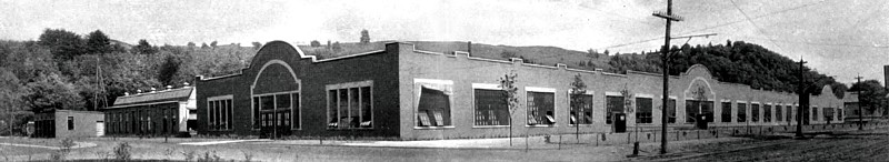

Jones, Lamson & Co. Lower Factory ca 1917
