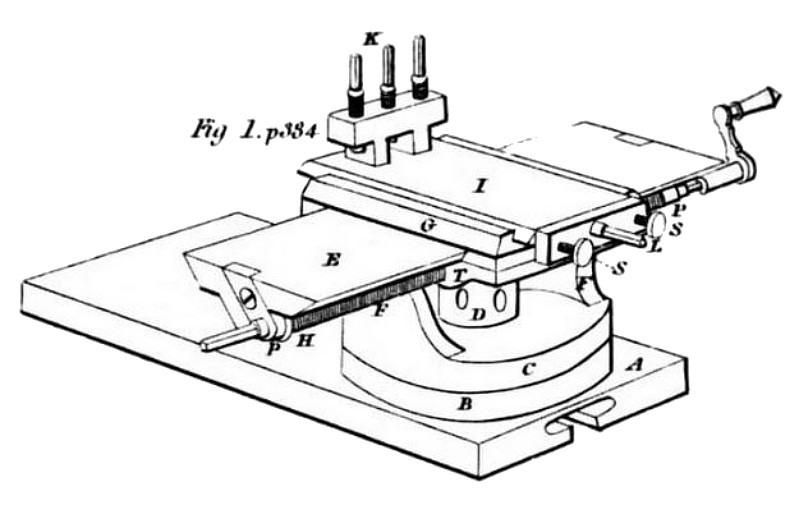

A, fig. l. (see plate) represents a piece of metal grooved underneath, to receive the holdfast, as in the common rest, having a circular projection at B, made flat at the top, forming a bed on which the circular base C rests, and is held fast to it by the screw-bolt D, in the centre of the base.
E, the main-bar connected to the base C by the supports F F, made perfectly flat on its upper surface, having the edges parallel and beveled under, to fit the dove-tail groove, in the lower side of the main slide G; in the top of the main slide is the dove-tail groove, crossing the lower groove at right angles, which receives the cross slide I, on which the cutting tool is placed, and may be held by either of the screws, K.
The screw H, which moves the' main slide is supported underneath the edge of the main bar by a collar, P, at each end, to protect it from chips, &c. and works in a semicircular nut, T, which is attached to the main slide. The collars P P being smaller than the screw, permit the nut to pass over them, and the slide to be taken off at pleasure; L, a screw by which the cross slide is moved ; it passes through the collar M, on the end of the slide T, and works in a nut formed in the bottom of the groove. At each end of the collar piece M, is a stop screw S, used in turning grooves of uniform depth, &c.
From the foregoing description, it is obvious that the cutting tool may be moved in the direction of either slide, or in lines at right angles to each other.
For turning cones, cylinders, concave surfaces, facing wheels, &c. the rest may be turned around the centre pin D, by which it is screwed down to the bed.
