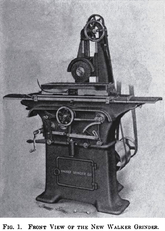

This new type of surface grinder, Fig. 1, is built by the Walker Grinder Co., Worcester, Mass. It is simple and rigid in design. The wearing surfaces are ample and the working parts are readily accessible. This machine is intended for continuous duty with the minimum of attention. Manufacturers will find this grinder useful for surfacing small parts which ordinarily are done on planer, shaper or milling machine. By the surface grinding method cost can be reduced and quality of workmanship improved. It is especially well adapted for finishing cast-iron parts that, are usually filed and polished, and, as coarse free-cutting grinding wheels of large diameter are employed, quite heavy cuts can be taken in stocking-out or roughing. The machine is equally well adapted for the ordinary grinding operations on hardened dies and general tool work. The base of the grinder is of T shaped cross section, providing a three-point bearing. The main bed, which is bolted to the base, has deep vertical cross section, and has apertures on the back side for the reception of projecting horns on the rear portion of the bed. The front and rear parts of the bed are bolted together, and the whole bolted firmly to the T shaped base. Extending into the interior of the main bed are widely separated V tracks, supported at the front ends by the horns. Upon these tracks is mounted a heavy wheel slide or housing, with corresponding legs or horns, on the front side, which extend through the apertures underneath the platen tracks nearly to the front wall of the main bed when the slide has been moved to its limit. This construction protects the cross-feed tracks, when the slide has been moved to its limit in a rearward direction. It also provides long bearing for the cross feed, and supports the housing slide to a point immediately under the grinding wheel. This construction is especially adapted to a surface grinder, as the weight supported is constant, and any length of main bed and platen can be used in connection with it.

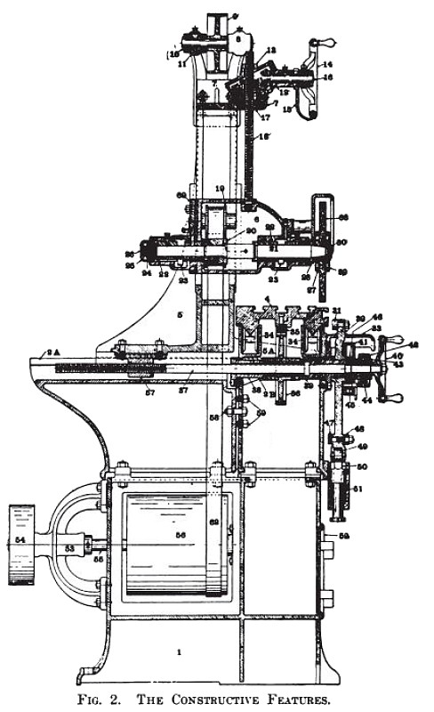

The spindle 21 is hardened and ground, and runs in hard bronze boxes 22, each being adjustable for wear. Lubrication is by the ring oiler 23. The emery wheels are fastened on iron centers, which are removably mounted on the tapered end of the spindle. The vertical slide 6 is also counterbalanced by a weight not shown.
This machine is substantially made with large wearing surfaces thoroughly protected from grit. The reversing is by means of a powerful friction clutch, not shown, but operated by the lever 47, which is in turn operated by the dogs on the platen in the usual manner. Three speeds are provided for the grinding spindle by means of step pulleys on the countershaft, and by means of a shift gear a fast and slow speed is obtained for the platen.
The capacity of the machine is 30 inches in length, 8 inches in width, and will grind 10 inches high with a full-sized wheel. The diameter of the wheel is 10 inches. The net weight of the complete machine is about 2,100 pounds. The machine can also be fitted with motor drive when desired. |
1908 Walker Grinder Co., #3 Surface Grinder
1908 Walker Grinder Co., #3 Surface Grinder (Sectional View)
