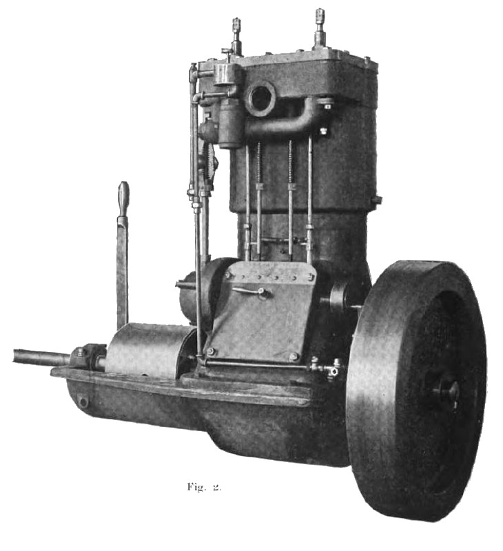

 The two-cylinder 16-horsepower engine is illustrated in Fig. 2. This engine is rated at 16-horsepower when running at 350 r. p. m. The base is 22½ by 44 inches; diameter of flywheel, 27 inches, and weight, 1,450 lb. Compared with one of the best-known two-cycle engines of the same horsepower, having the same number of cylinders, and running at 380 r. p. m., this engine is lighter by 50 lb. This engine also uses the constant-level fuel reservoir and suction feed as in the two-cycle engine, the reservoir appearing in the out just aft of the exhaust opening. In this engine and in the two-cycle is employed a peculiar type of the push-rod igniter, which gives a slight rubbing action at each contact, thus tending to keep the contact surfaces clean. This igniter is that commented upon under the head of Recent Patents in our last issue and is No. 664,110. Aft of the cylinders may be seen the gears which operate the governor. A governor, it may be said, is quite frequently placed upon a marine engine in these days. The engine is, as is usual, run constantly in one direction, and a solid propeller is used which is reversed by means of a clutch and gears.

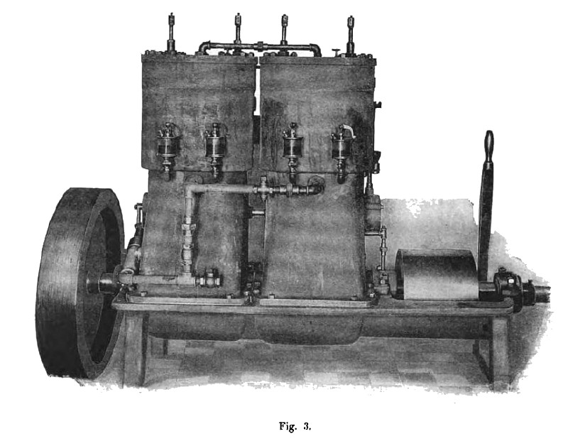

 The port side of the four-cylinder, 32-horsepower engine is shown in Fig. 3. With the exception of having four cylinders, this engine-is in other respects the same as the 16-horsepower. It runs at 300 r. p. m., has a base.22§‘by 62 inches, a flywheel 27 inches diameter, and the total weight is 2,700 lb. Comparing this weight with a two-cycle engine of equal power, we do not find a four-cylinder, two-cycle engine, but a thirty-horsepower, two-cylinder engine of this type running 300 r. p. m., weighs 3,000 lb., and another make under the same conditions weighs 2,600 lb., while a two-cycle, three-cylinder running at 340 r. p. m weighs 2,900 lb.

  1901 Globe Iron Works, 16 H. P. White Gasolene Engine
  1901 Globe Iron Works, 32 H. P. White Gasolene Engine |  |
