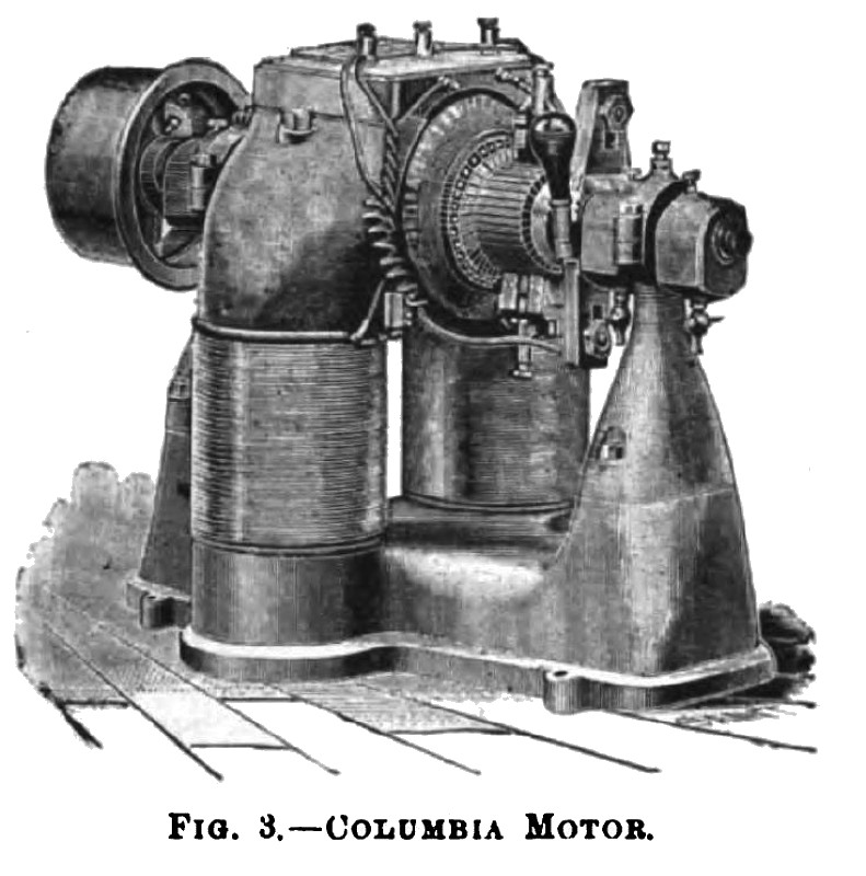

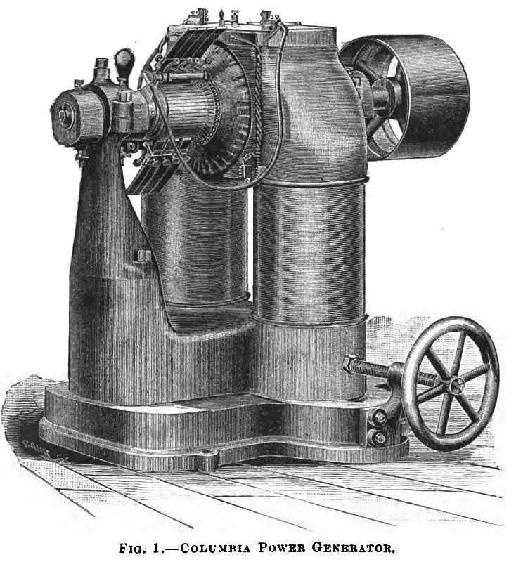

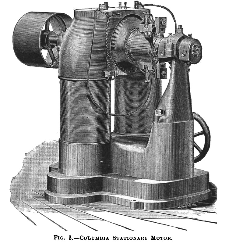

Fig. 1 shows the Columbia electric power generator; Fig. 2, their large stationary motor. Fig. 3 represents a small Columbia motor.
It will be readily seen from the cuts, that the power generators and dynamos are of the same general form as the stationary motors. The magnet cores of each machine are made of the best quality of charcoal wrought iron, giving much higher efficiency than is possible to attain with cast iron cores. The armature cores are thoroughly insulated with pure asbestos and mica; the same materials being used for insulating the spools upon which the field coils are wound. The commutators are insulated entirely with mica, and are so constructed, it is said, that It is impossible for the bars to become loose.
And by reference to the accompanying Illustrations, it will be seen that the Columbia dynamos, motors and generators are provided with self-oiling bearings and self-aligning journals; and in large sizes they have a perfect belt tightening device. Carbon brushes are employed on all the motors when wound for 220 volts or over; and, when so ordered, may be run in either direction or reversed at will. The carbon brush-holder is extremely simple and is so constructed that a uniform pressure of the brushes against the commutator may be maintained until the brush is entirely worn out. Motors over 5-horse-power have sub-bases and screw, for belt tightening.
