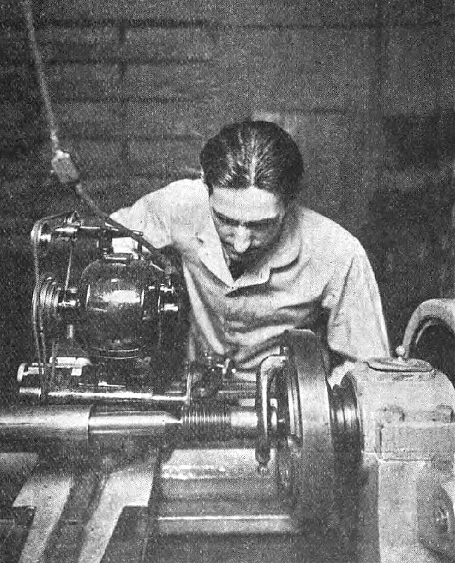

Separating arrows indicate the adjustment necessary for taking up the end thrust wear. A knurled knob is provided, operating the horizontal traverse to adjust the wheel in relation to the lead of the thread, and after the grinding operation has started, to adjust the wheel to grind on the side of the angle having the greatest amount of distortion, also when nearing the finished diameter size; to bring the wheel slightly to one side in order that machine will grind on one side of the angle only, thus making it possible to grind to within a 0.00005-in. limit. Fig. 2 is an illustration of "Grinding a large thread gage" and showing how the machine is "tipped" to obtain the proper helix angle.

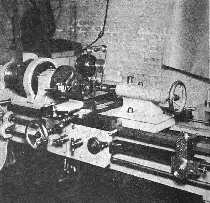

Fig. 3 illustrates the grinder and Precision thread lead variator installed on a lathe. The new thread lead variator and the Precision grinder being used in conjunction producing threads with precision leads on any lathe even though the lead screw may be worn. With this variator metric threads or threads of off or unusual leads can be cut on any lathe. The lead may also be elongated sufficiently to compensate for shrinkage in hardening. The variator is made in two sizes and is adjustable to fit all lathes.
