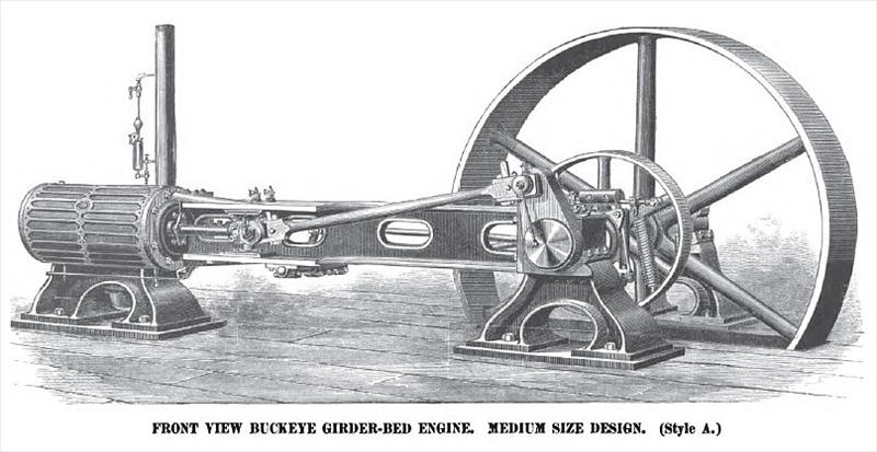

The engraving on the opposite page represents the Buckeye Engine with girder frame, and on the following pages are shown illustrations of the other two styles of this engine. For convenience we will call them styles A, B, and C.
Style A. This is the original or standard design, which may be called the girder frame, since a cross section of the frame is substantially that of the I girder modified to obtain greater lateral strength. It is provided with feet or pedestals under the cylinder and main shaft bearing, and in the larger sizes with an intermediate foot as shown in Fig. 1.
This style is best adapted to moderate rotative speeds. The proportion of stroke to bore adhered to is generally about two to one.

1890 Buckeye Engine Co., Girder Bed Steam Engine

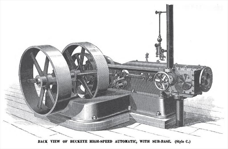

1890 Buckeye Engine Co., High Speed Automatic Steam Engine
