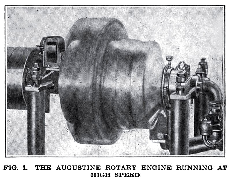

A new design of rotary gas motor is the Augustine rotary two-cycle super-induction air-cooled engine, Fig. 1, which has been developed by the Augustine Automatic Rotary Engine Co., 1862 Elmwood Ave., Buffalo, N. Y.

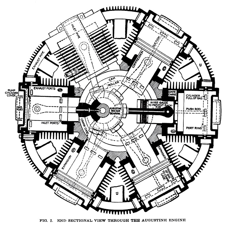

Figs. 2 and 3 illustrate the general design of this engine; the former is a sectional view through the motor in a plane at right angles to the axis of the driving shaft and centrally through the cylinders, also showing the relative positions of the pistons in the radial cylinders and the stationary shaft, bearings and connecting-rods. Fig. 3 is a sectional view in the plane of the axis of both the stationary and driving shafts, showing the assembled parts and how the lubricating oil is carried in copper tubes to the bearings and how the oil is kept cold by the incoming charge of gas.
The fuel gas is drawn from the carburetor through the hollow shaft A, Fig. 3, by the pumping action of the piston and is delivered to the crank casing, where it is put under slight compression, the degree of compression being controlled by the throttled condition of the carburetor. The passage of the fuel gas is from the hollow shaft A through the stationary controlling valve B and intake pipe C to the space D in the cylinder between the piston and the cylinder head, as shown by the arrows. As the sleeve valve E has closed the exhaust ports when the piston is at the compression position, the gas in the space D is forced back through the pipes C and F, past the valve B and into the crank casing of the engine when the piston begins its outward stroke, the valve B having moved to permit of its passage and so has cut off the supply of gas from the carburetor from the cylinder that has reached the compression stroke.

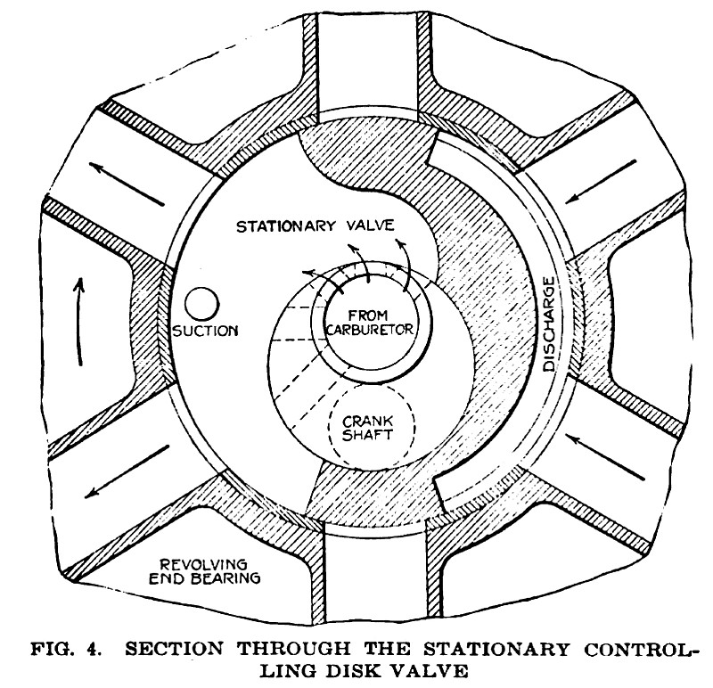

Fig. 4 is a sectional view of the stationary controlling disk valve showing the alternately intaking and discharging pipes that lead to the different cylinders. It also shows by the arrows the intaking of the charge from the carburetor and the discharging of the gas charge into the inner chamber by positive cutoffs above and below, the engine rotating in the direction of the curved arrow. As shown, the gas passes to the chamber D, Fig. 3, at the same time and is being forced into the crank casing from two opposite cylinders during the same period.

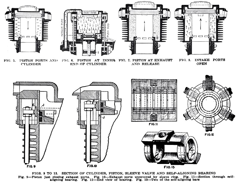

The fuel gas passes directly from the crank casing to the cylinders, entering through the intake ports G, Fig. 3, which are at the inner ends of the cylinders. A separate view of the piston, ports and cylinder is shown in Fig. 5, which also shows how the super-induction is effected, the sleeve E, Figs. 3 and 5, having closed the
exhaust ports and the full pressure of the inner chamber being admitted into the cylinder before cutoff and compression begin.
With the piston at the inner end of the cylinder, Fig. G, and the exhaust ports closed, the cylinder is filled with fuel gas drawn from the carburetor through the hollow shaft and intake pipe leading to the outer end of the cylinder. The greater piston area on the pump side is responsible for the super-charge that is brought in and then transferred to the inner chamber as the piston reaches the other end of the stroke. Compression is effected between the inner face of the piston and the inner end of the cylinder before exploding and expanding, and the spark plug H is located in the center of the charge. The screen on the intake ports / is to prevent backfiring.

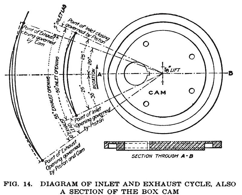

After the explosion in any one of the six cylinders takes place, the burnt gases are expelled through the exhaust ports J, Fig. 3, at the outer end of the cylinders. These exhaust ports are controlled by a sleeve which is positively moved by the cams and push-rods K and L, the movement of the sleeve being so timed as to close the exhaust ports prior to the closing of the intake ports G. By this super-induction, brought about through the closing of the exhaust ports and the pumping capacity of the piston, which can deliver a large volume of gas to the cylinders, a very high volumetric efficiency is obtained, even at high altitudes in airplane service where low atmospheric pressures are encountered.
An idea of the action of the gases in each cylinder may be obtained from an examination of Figs. 7 and 8. The former shows the piston position just as the exhaust gases are released by the piston uncovering the ports and thereby relieving any pressure before the inlet ports are open. Fig. 8 is a similar view, showing the intake ports open and the cylinder fully scavenged of the burnt gases and the sleeve at the point of closing the exhaust ports. It also illustrates how the spark plugs H have a complete scavenge with the new, clean charge of dry gas, insuring easy ignition. As the exhaust ports are at the outer end of the cylinder and the inlet ports at the inner end of the piston cylinder, this prevents cycloning of the in-rushing gases and causes natural scavenging, owing to a "uniflow" of the gases.
In Fig. 9 is shown a partial view through the upper portion of a cylinder at one side, with the piston just closing the exhaust ports and the sleeve for the closing of the exhaust ports about to move and uncover them. At this position of the piston there is no pressure on the sleeve, therefore it is moved practically without friction. Fig. 10 is a similar view showing the exhaust ports uncovered by the sleeve and the piston just reaching the

ports, which it also uncovers and thereby effects the exhaust. After the compressed charge has been exploded and the piston has moved to its outer stroke, the sleeve valve E, Figs. 3, 9 and 10, uncovers the ports J and the incoming charge of fresh gas from the crank casing forces the burnt gases out through the ports J into the exhaust pipes V, Figs. 2 and 3. This cycle of events takes place in each cylinder in rotation.

Each piston rod is connected to a pair of rings, and these rings are nested and engage two floating sleeves mounted on a fixed crank. By having a pair of rings, all side thrust on the piston rod is avoided. The end cups surround the ends of the connecting bars carrying the rings. A compression ring is slipped over the connecting bars and engages the groove therein. This compression ring also engages the inner surface of the cups and thereby forms in each cup a lubricating pocket. The oil for lubricating the crank is carried by a copper tube through the hollow fixed shaft as at M, Fig. 3, and passes out through oil grooves in and about the floating sleeve into the end cups and also out through the connecting-rod to the wristpin and to oil ducts leading to the cylinder walls. This arrangement gives lubrication for every desired part of the engine, and also insures that the fuel gases are free from the lubricating oil.
A side elevation through the center of the self-aligning bearing is given in Fig. 11, in which the two inner sleeves and the oil channels are shown, also the end cap bearings that inclose the outer section of the bearing. The two expansion rings on the inner ends of the caps are for retaining the oil film. Fig. 12 is an end view showing the various sections of the self-aligning bearing and the oil ducts leading up through the connecting-rods to the wrist-pin, through which the oil is equally distributed by centrifugal force through all parts while the engine is in operation. The ensemble of this self-aligning bearing insures alignment of the piston rods between the crank and the wrist-pin centers and at the same time constitutes the center along which all pistons and their rods revolve in a balanced centrifugal condition, with no reversal of direction of pull on the connecting-rods. Fig. 13 is a perspective view of two of the self-aligning bars with annular rings, which, when assembled, are mounted on inner creeping sleeves.

1918 Augustine Rotary Two-Cycle Gas Engine (End Sectional View)
