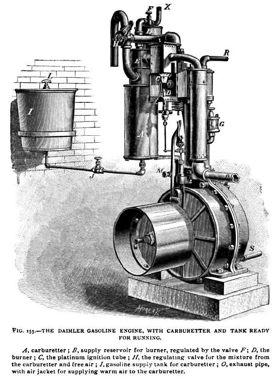

The operation of the governor is transferred through a grooved sleeve to the lateral arm of a bell-crank push-blade on the push-rod of each cylinder, by a vertical pivoted lever carrying a stop-block, which is thrown out and into contact with the arm of the bell-crank push-blades, and makes a miss-opening of the exhaust valve, as shown in the duplex motor (Fig 156) and also in the single-cylinder motor (Fig. 155). By this arrangement the movement of the piston, with the exhaust valve closed, simply compresses and recompresses the burned gases, and allowing no fresh charge to enter the cylinder until by the return to normal speed the governor allows the push-blades to act on the exhaust-valve spindle.

1898 Daimler Motor Co., Two-Cylinder Gas Engine (Ready to Run)
