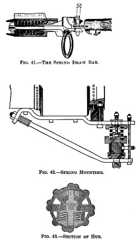

The engine is of the side-crank single-cylinder type, with cylinder, guide, and crankshaft bearings all in one casting. It has a belt-driven horizontal governor and the Huber reversing gear. The connection between the crank-shaft and the driving-wheel consists of a train of spur-gears. In this train of gears is also included a compensating gear which is constructed with spur-gears for pinions. This compensating gear is enclosed in a casing and covered by a steel plate, making it perfectly dust-free. Between the last gear and the driving wheels four spiral springs are introduced. Springs are also used between the drivers and the axle (see Fig. 43), between the front axle and the boiler (see Fig. 42), and between the draw-bar and the engine (see Fig. 41).
