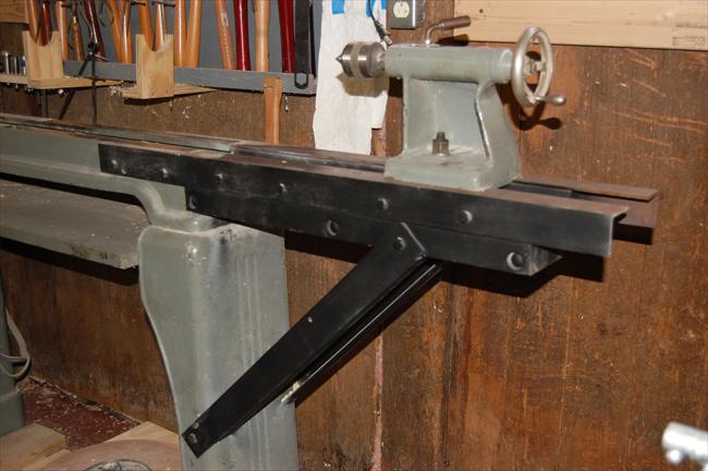

I did add a bed extension up to five feet, when I got a commission to make a set of six shaker ladder-back chairs, with back posts of 42 to 48 inches tall. See pics below.
Any suggestions for also finding original bed tool rests?
Comments: Walker Turner lathe, with shop-made 60" bed extension
Source: My photo
Comments: Close up of bed extension - basically a couple of steel anges bolted through the bed and into the base. Wood was used to precisely space the angles
