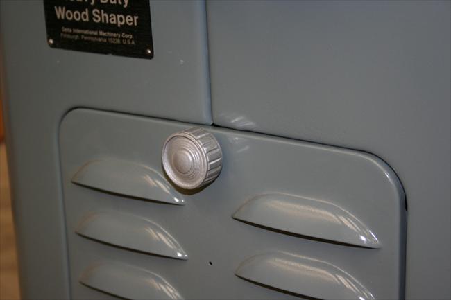

US Govt Auction in NC. No indications of prior user. Full restoration of cartridge, turned pulleys, new bearings in motor. Orginal base was rusted, so used a older cast iron one. Set of grizzly spindles was turned down to give a full set.

had to replace this with an older style base
Made the replacement knob on the lathe myself
