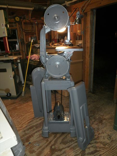

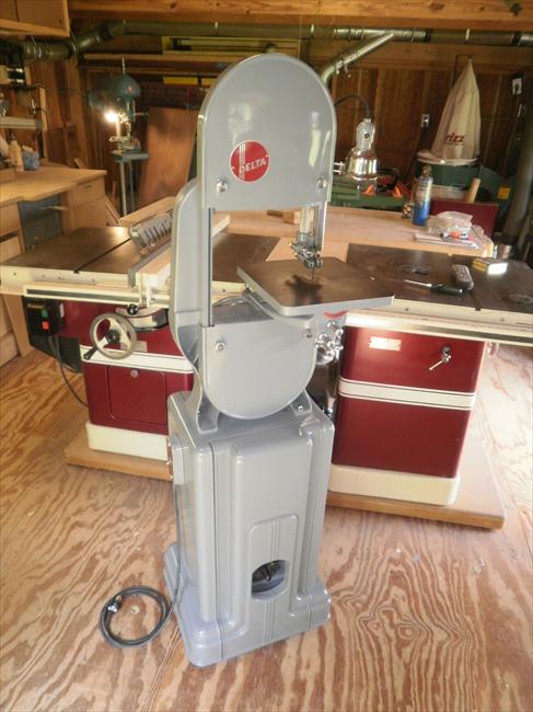

Front on its new stand
me and my camera

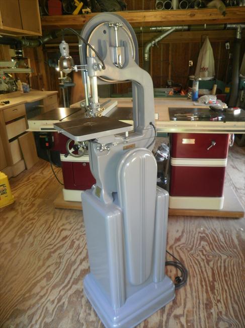

Rear
me and my camera

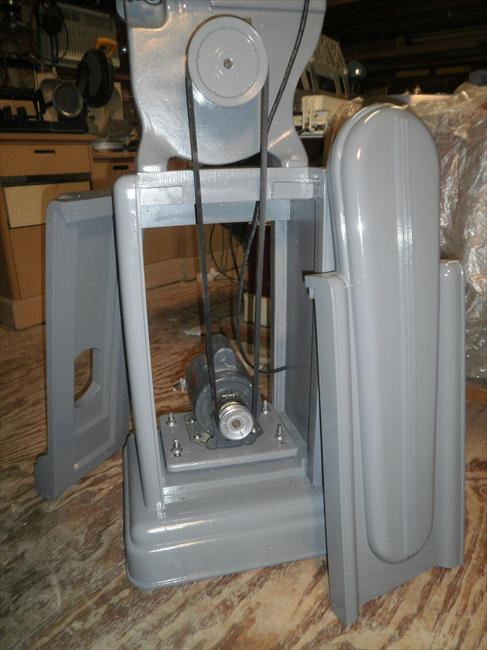

Covers off on the front
me and my camera

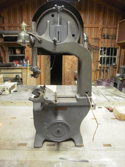

"Before" rear
me and my camera

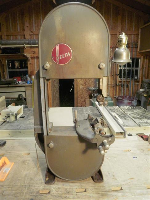

"Before" front
me and my camera
