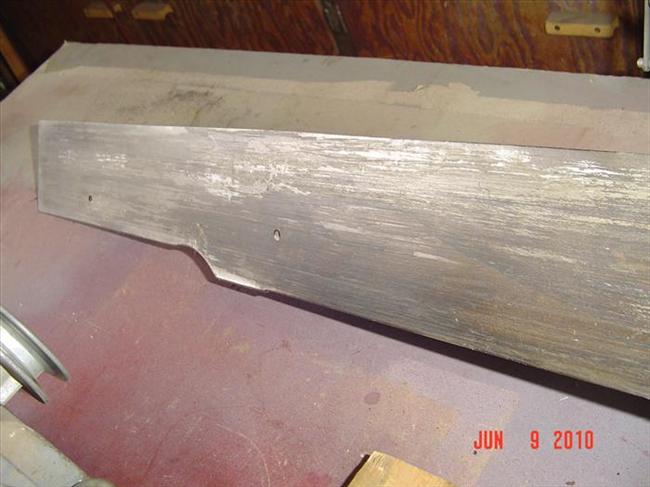

This jointer has the original motor, I think. It's a 82-710 model, 1/2hp, 1725rpm, dual voltage and reversible. Starts up real good. No bad noise of any kind. It did have the condom once, but a piece of it remained. The only serious problem with this jointer are the blades. They were grounded on a fast dry grinder and were held by hands. They are ruined beyond the minimum width. Definitely new blades! Oh, one more thing. One of the gibs was installed upside down. The fence was a mess on its face. Bits of silver paint and some weird dark brown stuff that ate up four razor blades and about a hour to get it clean. I couldn't figure out why people do these sloppy jobs. Good thing I did in rescuing this jointer. The home made rear belt guard looked like it was very well made and covers both pulleys.

What a bugger of a mess to clean up!
