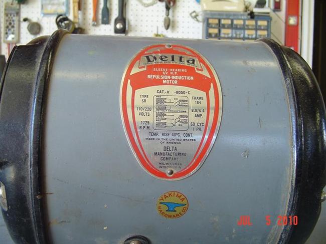

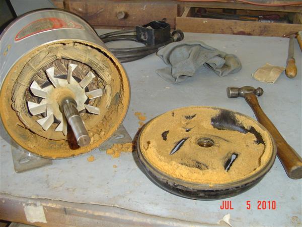

This motor powered the 1941 20-200 ts and the 22-110 jointer. Cleaned out all the wood dust and checked for any problems. It is in excellent shape. Bearings have been replaced sometime in the past, according to the PO. Surprised to know this huge motor is only 1/2hp. I believe for a combo set, this should be 3/4hp or more. After I assemble this combo set, I'll find out if this motor is adequate.
Note - this entry was updated to move it to the "Motor" category. The original entry was dated 7/13/2010. DG
Nice looking tag along with the original dealer decal.

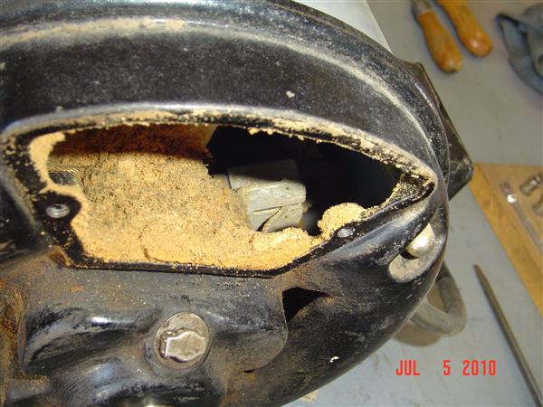

I wonder how much wood dust is in there.

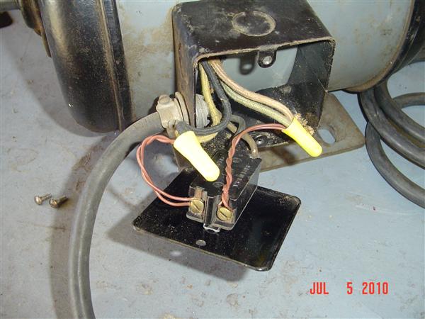

Funky wirings. The flat toggle switch turns on intermittently.
Now I know how much. A quart and a half and then some.

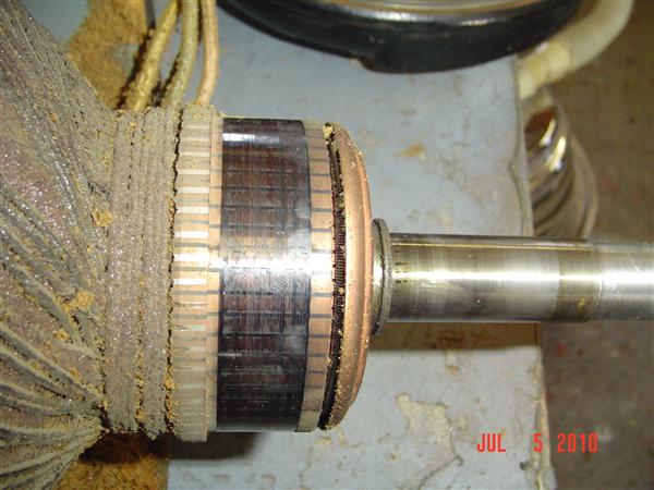

Despite the color, no copper bridges between the commutator bars.

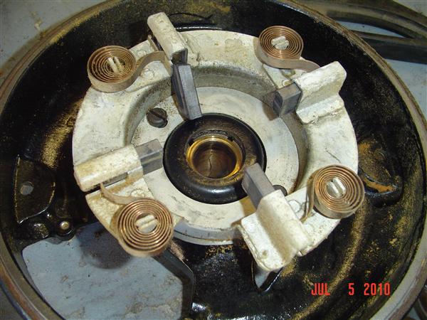

Brushes almost brand new. This is a adjustable plate type.
