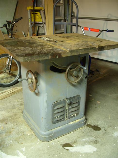

Got this from a guy who used to liquidate for Sauders in Archibold, OH. It was sitting in a loft in his pole barn.
The saw was missing original switch, motor cover, blade guard and internal dust deflector. The front rail apparently had an accident and was bent and caved in on one end but the fence was ok along with the back rail. THe origianl 1.5 HP 3PH motor came with it but it also came with a 1 HP single phase bullet motor for use (Thanks to owwm.org ofr figuring that one out).
The arbor bracket had been brazed but it looks pretty lined up so a new set of bearings and off we go. Saw will get the complete tear down and rebuild with new paint etc...

Saw as found with rails removed
