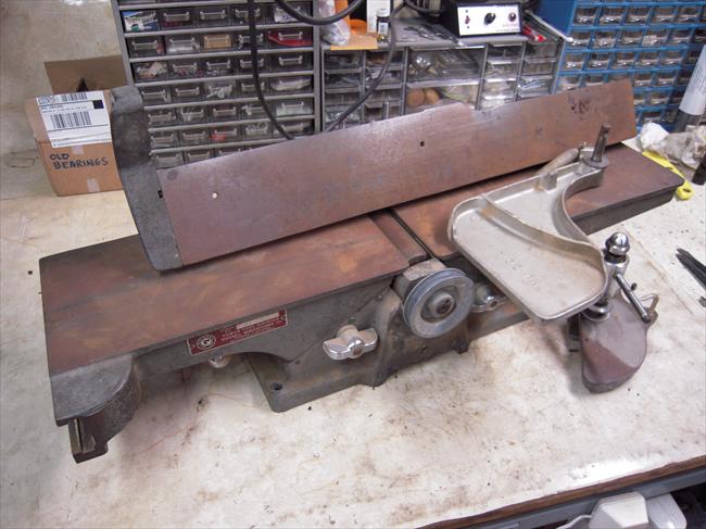

Delta Milwaukee Rockwell 6" short bed jointer.

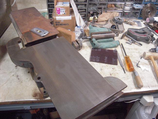

Missing Saturn knob from fence handle. Fence handle and protractor assembly damaged.

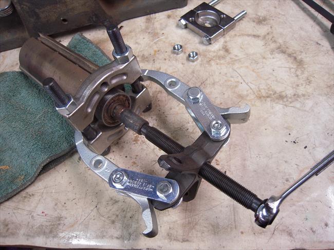

Original ND (USA) shielded bearings were dried out. LH side-87502, RH (pulley) side-87503
Installed new IKS (Japan) sealed bearings, from Accurate.

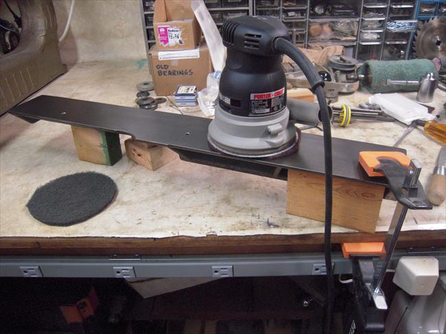

Removed machined surface rust with the razor blade scraping technique.
Cleaned machined surfaces with a maroon Scotchbrite pad on a random orbit sander.
Waxed machined surfaces with Gulf paraffin.
Overall the paint was in decent shape, so I left it as is. I needed a user 6" jointer now.

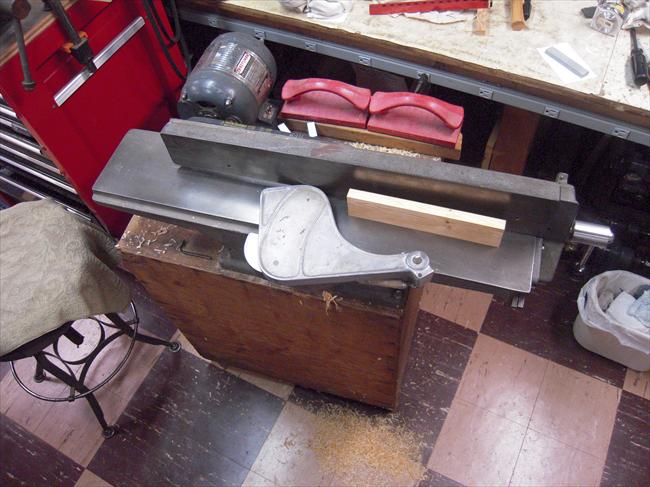

Repaired fence protractor. Made a lock lever from a 3/8" bolt. Installed a NOS Saturn knob.
Honed knives and adjusted with a dial indicator.
Mounted jointer to a temporary rolling cabinet.

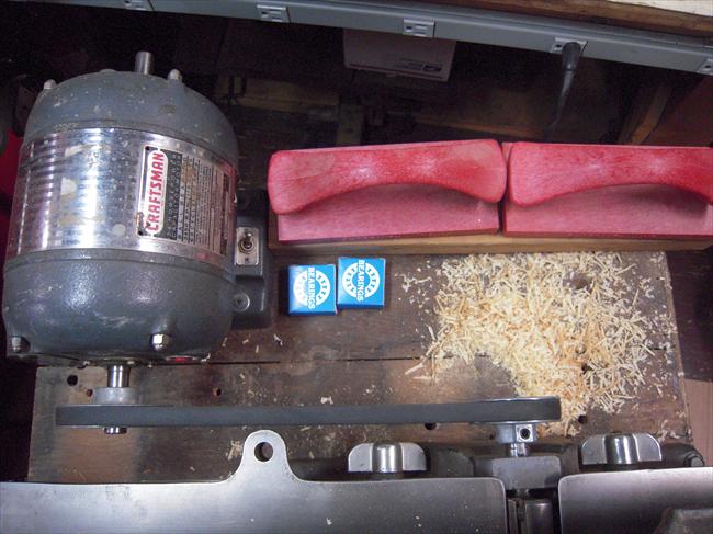

Power supplied by a 1955 Craftsman 115.7534 ¾hp 3450rpm ball bearing capacitor motor.
Machine pulley-2½", motor pulley-3¼", cutter head speed ~4500rpm.
This jointer is very solid and smooth.
Before
Nikon Coolpix, existing light, basement shop.
Up and running!
Motor and drive
Nikon CoolPix existing light in basement workshop
Pulling cutter head bearings
Scraping the beds
Cleaning the fence
