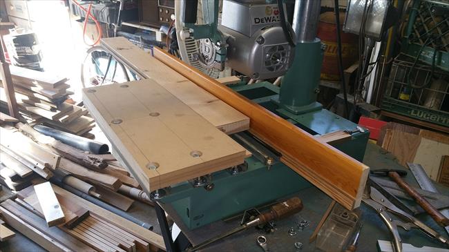

Purchased off Craigslist for $70 (Dec 2010). Needs table and typical cleanup maintenance. Runs good.
11/2014 Update: Other than a Freud neg. rake blade, table and dust collection box the planned restoration has been put off till later. No time for cosmetic projects right now.
4/18/2016 Update: Been rebuilding the saw. Nearly done. Machine and table done. Cabinet and dust collection needs completion. Table is a custom design that includes a sliding section which stays aligned with the main table by using a spline and groove. Provides support for long boards as needed on either side of main table. Table is mounted on Unistruts which I think is a better design than the Mr. Sawdust table. Easier to build and easily replaced without the need to epoxy steel bars. I think it provides more support. Sacrificial top is laminate flooring. Also easy to replace. Mounted with pin nails. I like it because it is slippery and hard and cheap. The saw kerf maintains a sharp edge which provides zero clearance cuts. Paint is a near match to the original. It's DupliColor Detroit Diesel Alpine Green high temp engine paint with their primer applied first. Very nice paint.
Comments: Rebuilt: Model 1400
