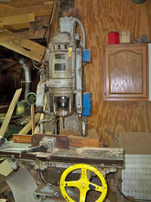

I bought this in Louisville from Bob Kirchner (Louisville Woodworking Machinery) several years ago, have never gotten around to repainting it allways in use. It has a 5hp motor on the bit and 1hp on the hydraulic pump, the table is 48"long x 11.25" wide, moves 24" side to side, table tilts 45 left and right, the machine stands 89"tall would guess the weight at about 2600-3000lbs. Realy good for cutting long mortise joints the head will keep moveing up and down as long as you hold the foot pedal down. Hope to clean it up and paint it I'll post pictures when I'am done. Any one know any thing about this machine? I was told it came from the Navy but dont know.
Comments: side showing valves
