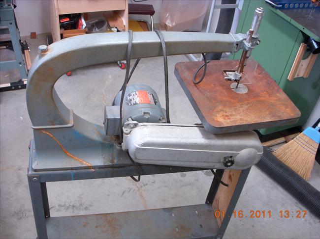

Purchased off CL in Jan 2011 for $100. A former High School scrollie, it was stored outside, was in semi-rough shape, and came with colony of stink bugs free of charge! Needed a good cleaning, motor bearings, belt, motor control/wiring and, as a single speed, new 4 speed pulleys and replaced the air pump shaft. Scraped the table and gave it a coat of paint. The retirement light was on one of my non-delta machines so I married it to this one for the sake of accuracy (and efficiency). It's a nice machine and a welcome replacement for the Ryo*bi POS I had before. Total invested: about $250. Many thanks to the folks who posted the motor and pump rebuild info in the Wiki Knowledge base!
As purchased
