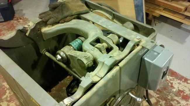

It has definitely had a hard life, -- one of the trunnion supports mounts' was cracked off. I was able to braze that back in place. (see lower left corner of second photo, below)

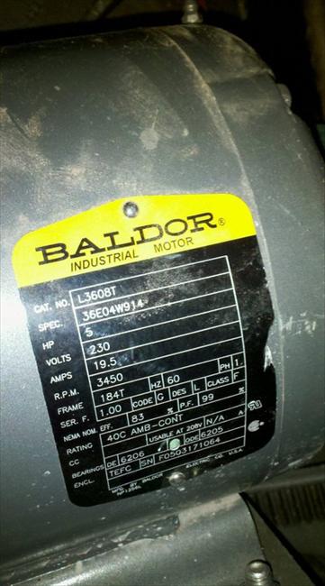

I scored the brand new Baldor 5HP motor, a stack of 12 & 14" blades, and a Forrest Dado set off of Ebay.

It is now up & running with a 5HP 220V SP motor. It works great! I was concerned that the SP motor would draw too much power for my home electrical service to handle. Much to my surprise, it spools right up. It rips 3.5" of wood on a single pass, without hesitation. That is what I'm talking about! It runs smooth as butter-- no tools/pencils, etc will be vibrating their way off this thing.
