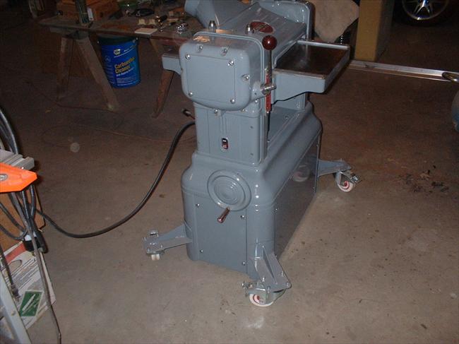

This 22-101 was a low hour machine but it had seen some abuse but, the worm gearing in in great shape. The bed/table looked like someone had run some timbers though it and forgot to look for spikes. It was completely torn down, cleaned, painted and new arbor bearings installed. The gouges in the table were removed by taking it to work one day and sticking it in the big wet surface grinder. The base guards and belt guard were missing so I fabricated new. The old 3 phase motor was replaced with a 3 HP single phase and the starter converted.

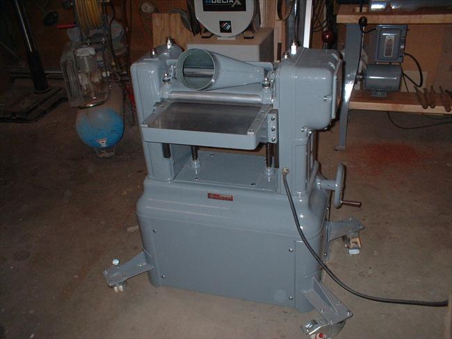

Rear showing new adapted dust hood

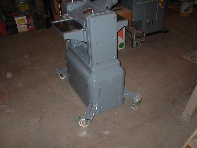

New belt guard with louvers
