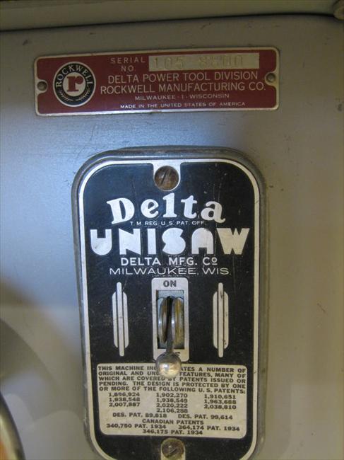

105-8800

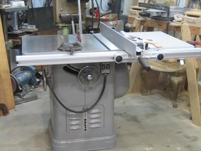

Bought at auction for $40, bidding against a scapper. Came with fence, bullet motor, and door. One missing locking knob and cracked front trunnion. Took motor to be rebuilt and discovered that they had rebuilt motor in 1977. Full of aluminum chips when I got it, having been owned by siding company. Many drill holes in top and had re-ground. Replaced fence, arbor and bearings, added ci motor cover.
Got motor cover and Unifence of the bay.

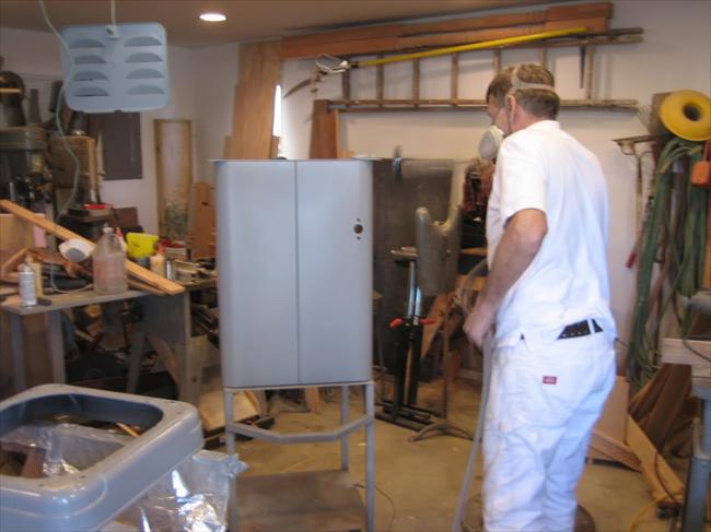

painter friend with electrostatic rig applying epoxy paint. no overspray, no problem painting in a dusty shop with one of these rigs!
