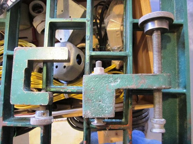

I purchased this powermatic 66 at a school shop auction and it included a gliding table attachment. I have seen a few photos of these but not details of the underside etc. so I thought I would add them here as a reference for those with this relatively uncommon attachment. Apparently they were only made for a few years and cost as much as the saw itself. What is nice is that there is a secondary on/off switch mounted to the guide rod. The normal on/off switch would be obscured by any sheet goods that you had mounted on the gliding table.

Comments: Gliding Table Fence Clamps (fit inside extruded aluminum channel)
Source: My digital Camera
