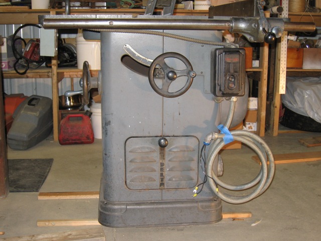

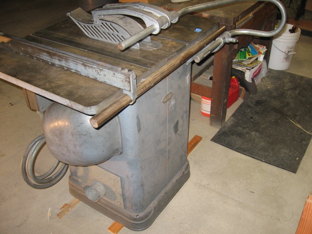

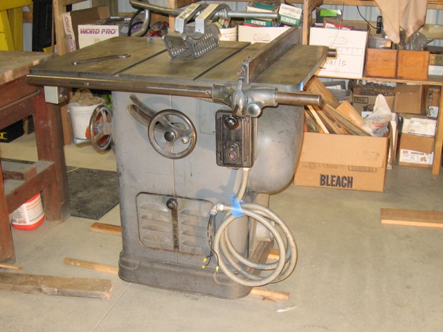

I picked up this machine from a dealer in the Cleveland area. I was happy to find one as complete and original as it is. Crack in one trunnion has been welded. It has a hole drilled at each corner of the plinth and a couple of ugly 4" dust ports hidden under a piece of sheet metal below the motor cover. My brother was kind enough to weld those closed and I'm trying to decide how to touch up that area without having to repaint the entire machine... The rails were cut short at some point. This is the second Unisaw I've had with toters bend in the tilt wheel handle from being pulled around. The handwheel was too big for my arbor press but I was able to use a cider press to straighten them back into alignment. The Unisaw switch plate on the starter mounting bracket is absent. I will likely get a VFD for it as the original motor looks to be in good shape.

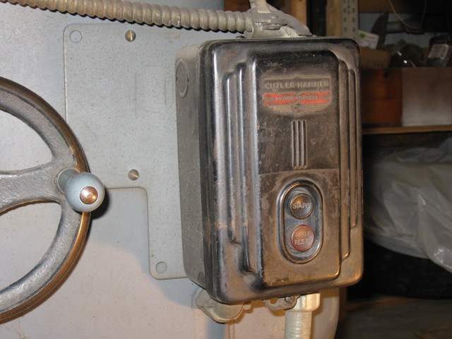

3 phase starter

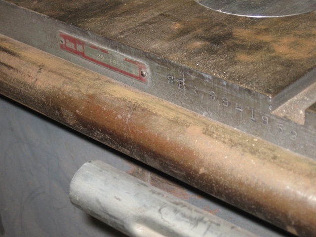

serial number at rear of table
