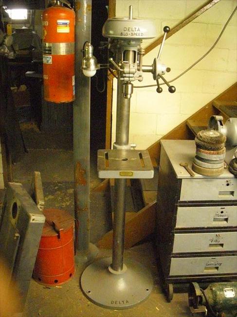

I bought this machine after seeing a postage stamp sized photo that didn't do justice to the working over this old gent had received from the P.O.;The table was nearly drilled in half, the column was scarred from something with a set screw being drug up and down without being loosened, and the quill had been replaced by one from another machine, which required the quill clamp to be way overtightened to get the quill to stop wobbling,thereby causing the headstock to take a permanent set.I was a little bummed when I saw it in person, but I payed for it anyways.
I rebuilt this lathe right after going to my first get-together of owwm'ers , and I really think that if I hadn't spent all day talking to other members, I wouldn't have tried to save it.You people are a bad influence (I'm kidding).I repainted it, installed a motor I got from bigjoe,a quill and spindle from daveg59, and a table and column clamp from BAM.Oh, and I benefited from Jamie Norwood, both in his excellent restoration of a similar drill press, and his post about making bushings to allow replacing the original notched race bearings.

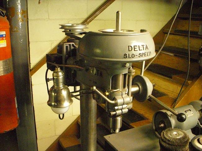

I'm not sure which model of "slo-speed" this drill press is,as I have my doubts about the originality of the spindle.In its day, it was available with a keyed and keyless chuck, as well as a #1 Morse taper spindle. I have the #1 and the keyed chuck, and it has proven useful to be able to swap out spindles.I upgraded it with a pilot wheel to replace the sliding bar; this was an upgrade you could buy from Delta around the time the drill press was being made.
After the rebuild, I was pleasantly surprised to see that the runout was better than many new drill presses.It appears that this machine has a lot of life left in it.

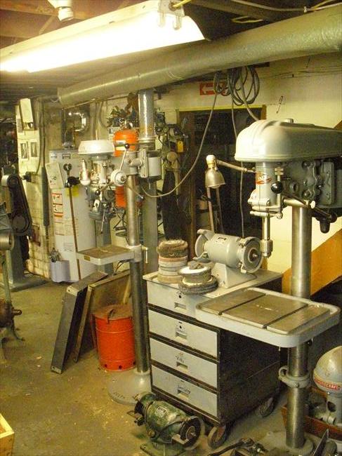

Ol' hick in situ

closeup of headstock

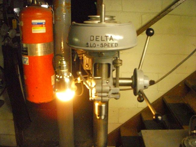

light and everything
