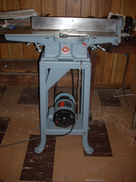

I found this jointer on Craigslist. It had spent most of it's life in a barn. I tore it all apart, sandblasted the castings, and primed and painted it. It received new bearings in the cutterhead and motor, a new motor pulley (broke the old one trying to get it off the shaft), new knives, new V-belt, and new electrical cord and plug. I also found a guard for it from a fellow OWWM member. It runs very smoothly.
After restoration
