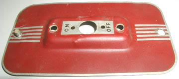

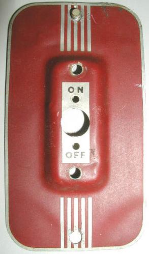

The pictures below are of what you would have received in the way of switch covers for the No. 34-260 and No. 34-265 Delta 8-inch Tilting Arbor Saw ("Junior" Unisaw).
The first two pictures are of the stock covers shipped with the saw. This cover is alumnium and has a raised center portion to accept a toggle switch. As the saw was sold the toggle switch would have attached directly to the plate and the plate screwed directly to the saw cabinet. The toggle switch would have been exposed on the back side to the inside of the saw cabinet and not housed in a box.
The two through holes each side of the center opening (between the words On and Off) would heve been the holes used to secure the toggle switch. The two larger holes (below and above On and Off) were added later by a saw owner. This was no doubt done in order to use another maker's switch.

Stock Switch Plate For The "Junior" Unisaw

Another View To Show The Raised Center
