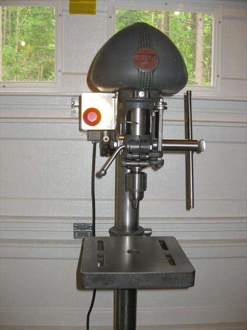

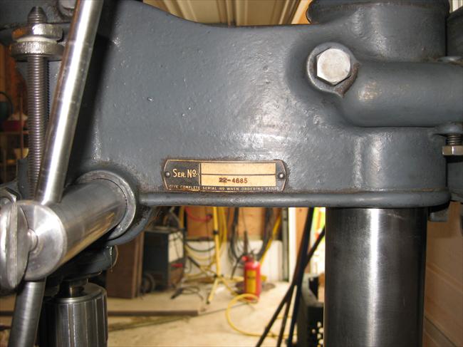

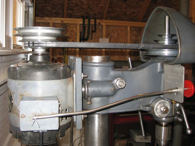

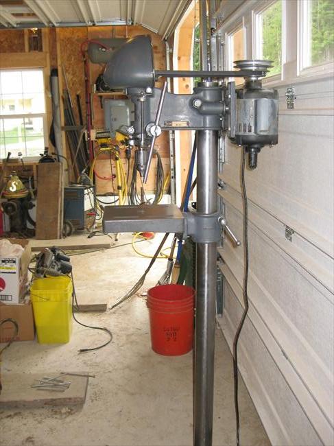

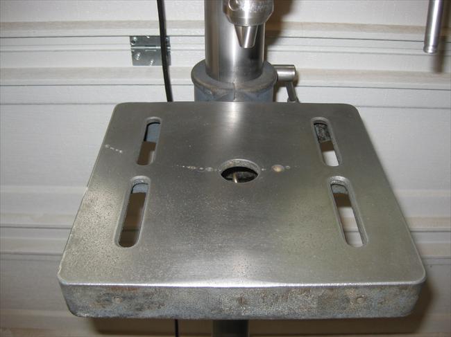

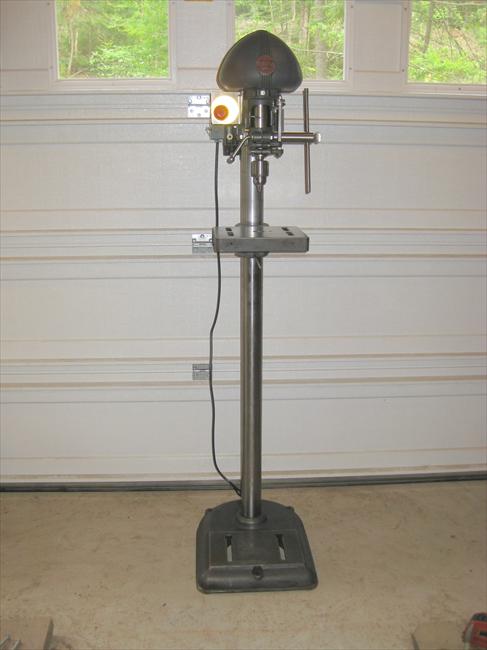

This is one of six that I bought to clean up and sell. I kept one and sold the other 5 to woodworking friends and could have sold several more. This was the last one that I did and it required more work than the others. I machined new bearing adapters for the new spindle bearings and new knurled stop rod nuts. The stop rod nuts are ½"x16 and required a special tap. They all got new belts and chuck keys and this one got new motor bearings as well. For one of the others I machined a bearing adapter for the spindle pulley bearing. None of the machining was overly challenging even with my limited skills. I used Simple Green to remove 70 years or grime and found the paint in remarkably good condition and chose not to repaint. I like the look of the shined bare metal and the old paint. The columns were removed and polished in my Wadkin wood lathe using a couple of casters to support the far end and a four jaw wood chuck on the other end, I wrapped the column in electrical tape to give the chuck something to grip. These machines were used in a production environment and in spite of being almost 70 years old were in very good condition. A tribute to the quality of these old machines.
1942 DP 220

Ser. NO. 22-4685
My Camera
Pretty good Table
My Camera
OSHA Approved Switch
My Camera

Right Side
My Camera
