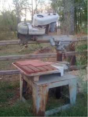

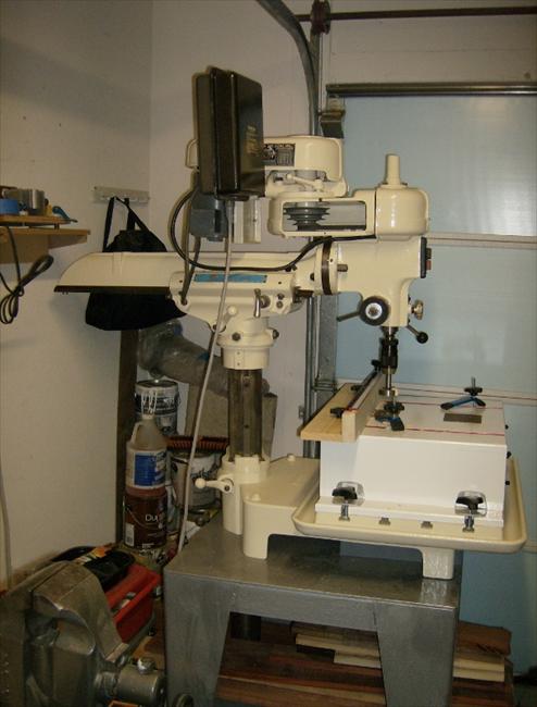

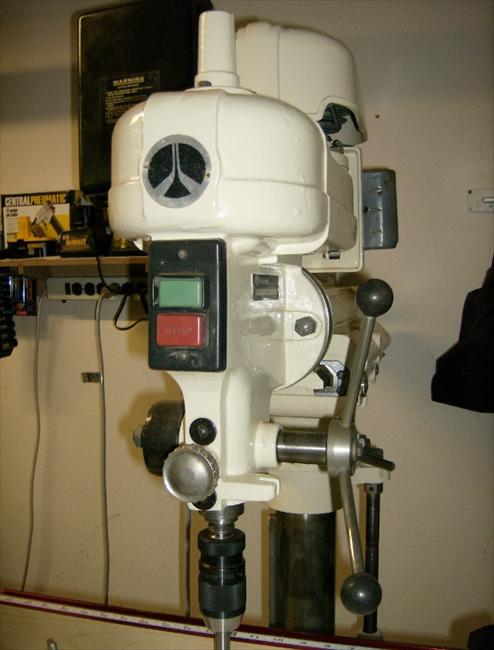

Purchased this radial drill press from fellow in OK, just outside Tulsa. He had taken in on trade for some work. Thought he could use, but determined that parts were missing and so placed up for sale. From picture on sale site I couldn't determine much, but found out that quill was missing along with upper pulley and associated stop collar and depth gauge. As it was cheap and I was already committed, I took apart, loaded up and took home. Tore apart and refurbished. Rusted up from sitting outside. Found replacement quill, not original, but it works. Delta offers parts, but close to $1500 for what was missing. More than my budget allowed. Replaced brgs in motor, removed dirt dauber's nests throughout and it works very well.
As Found in the wild

Side View as competed
myself
Head on
