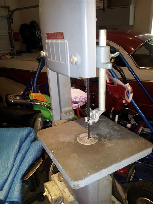

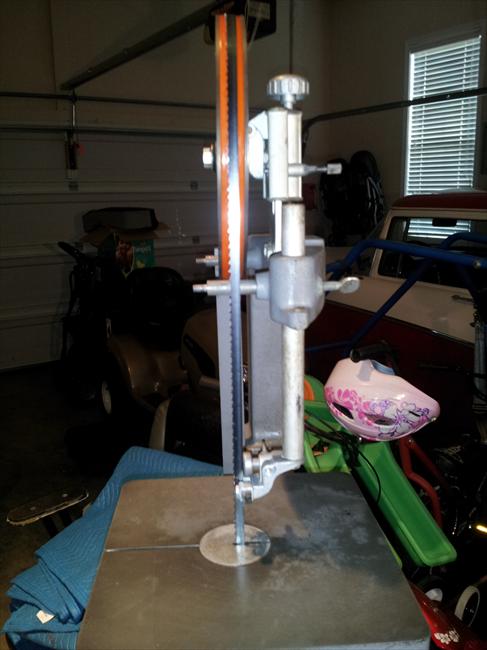

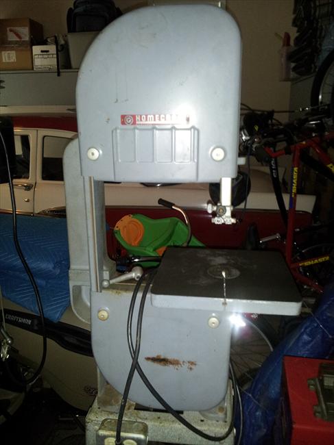

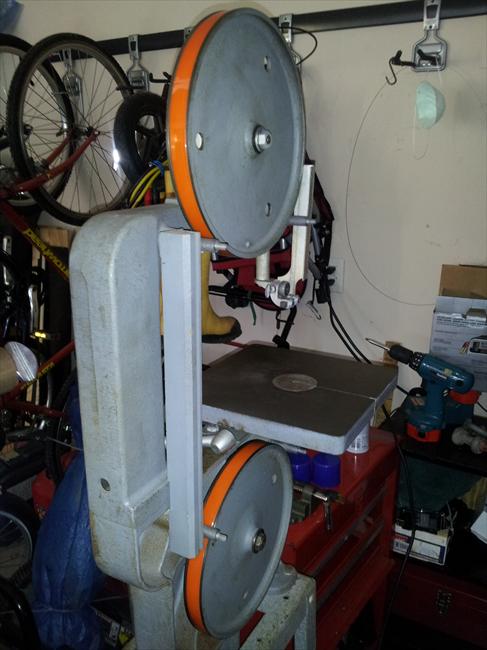

Acquired it with the drill press. The table was rusted and there was no band for it. the tires were original, dry rotted and slipping on the wheel. Owner not certain it even worked. I soaked all rusted parts clean, put urethane tires on it and a 4 skip tooth 5' 11.75" blade on it. works like a dream.
cleaned up table

new tires
me
New blade installed
me

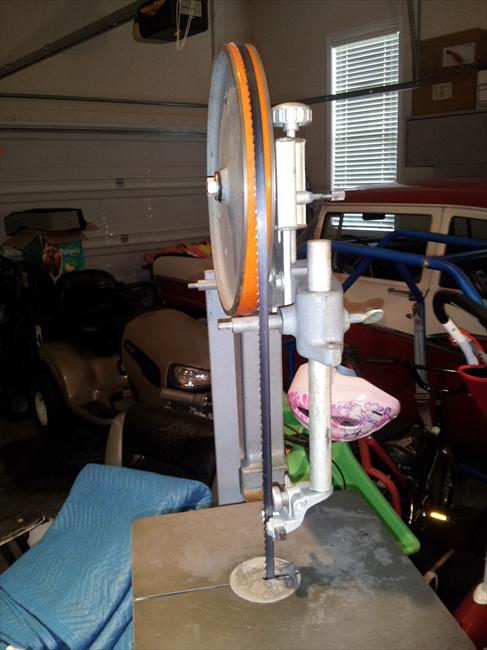

another picture
me
lines up well. I did put the blade guard on after testing it out :)

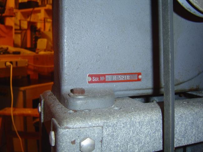

Serial Number
me
