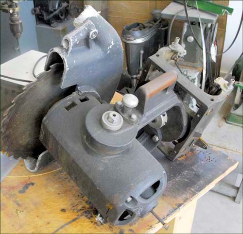

The head

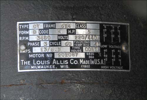

Motor tag

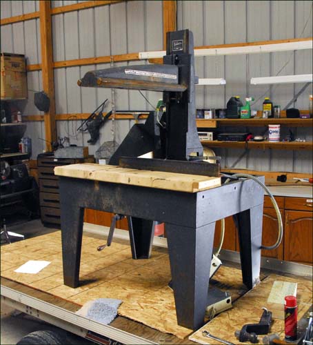

The table is 35" x 45". The machine stands 6' tall. The arm is 34"

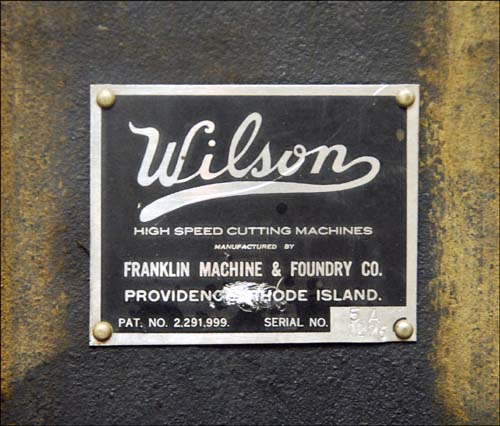

They don't call it a saw

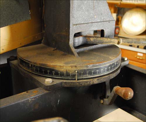

The protractor

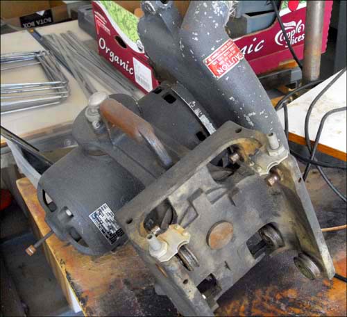

The roller bearings seen here glide on the square-section steel guides along the sides of the arm. I got lucky and found all 8 of them, though they were scattered all around the PO's shop.
