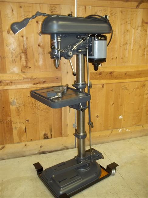

Found this Delta 17in DP600 from a fellow in Indianapolis Indiana. He stated that the machine was purchased new by the Carter Lee Lumber CO. of Indianapolis Indiana. The serial number of 26-577 dates the machine to 1943. The machine is all original and includes both the table and head, raise/ lower gears on one rack. It also includes the original foot feed equipment, although with a shop made stop. It has the original 1hp repulsion-induction motor. The standard table has been drilled and tapped for mounting vise. It also has a unique shop made on/off rod. All badges and labels are there and readable. It also wears a poor, dusty, coat of pea green paint. Machine looks to have had been cared for and seen only light duty for its first 69years. I hope to be its conservator for a good part of its next 69 years.

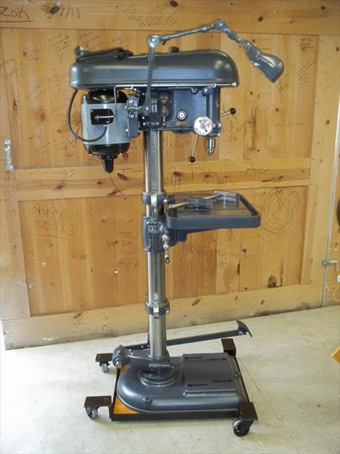

UPDATE 6-2015
Machine has been completely rebuilt with all new bearings in head and complete motor rebuild. Paint has been color matched to original. All nuts & bolts have been cleaned/polished, all moving surfaces oiled or greased. It now has a separate raise rack for the head and table to allow both to raise & rotate independently. The table has been replaced with a T-slot table and light has been added. Should be good for the next 70 years.
After complete rebuild
Left side after paint
Right side showing foot feed
On Off control rod note seperate head and table raise racks
