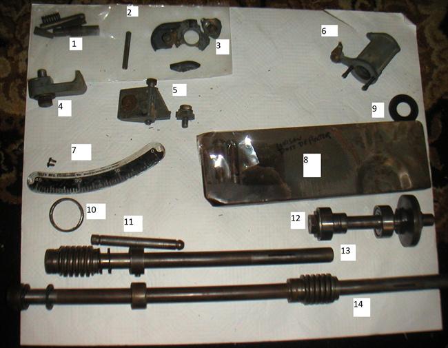

uploading photos for parts reference more than anything else. ID of small parts:
1. handle lock parts - two sets of wedges, one spring, one rod, one threaded part -
2. key that locks arbor casting to trunion
3. potmetal casting with original screws that tilt handle goes through1 ("special fillister head screws")
4. potmetal clip and bolt/washer that keeps the tilt gear/trunion running true - good condition
5. LTA 435, LTA 436 (potmetal) clamp with bolts, broken (splitter bracket?)
6. Potmetal casting with pointer for tilt, the elevation knob goes through this, screws included -
7. angle scale with screws
8. Dust deflector with screws and spacers $
9 fiber washer that goes behind elevation handle
10. Arbor Bearing retainer
11. Motor suspension pin
12. complete arbor with bearings, nuts, washers, etc
13. tilt worm with collar and taper pin, washer, shaft
14. Elevation worm with collars and taper pins, washers, shaft, etc
