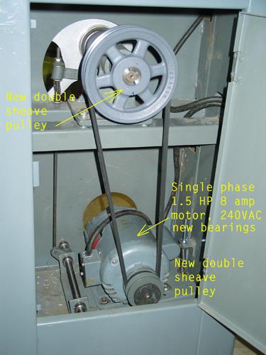

Here are some details of the inner workings of the 28-350 taken during restoration
Inside the motor compartment
my digital

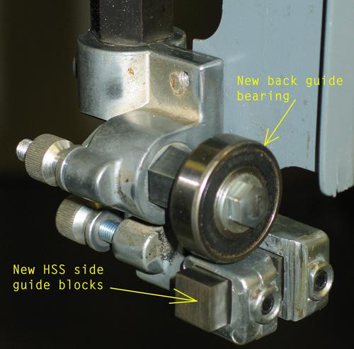

Lower guide detail
my digital

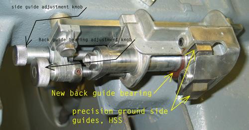

upper guide detail
my digital
