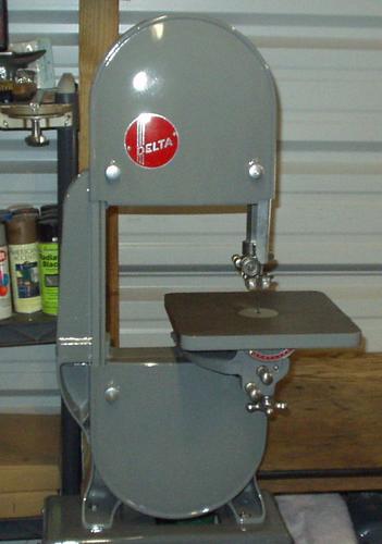

Delta Model 768 10" band saw on stand as found.
C.Garrett

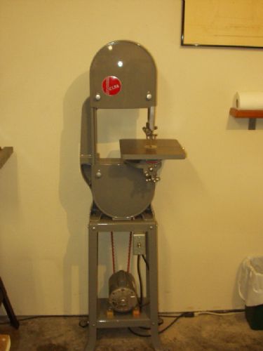

Delta 10" band saw restored with table top "Blanchard"ground flat.
C.Garrett
Delta 768 Band Saw on Delta restored bolt together flared foot stand with new 1/2-HP Marathon motor
C.Garrett

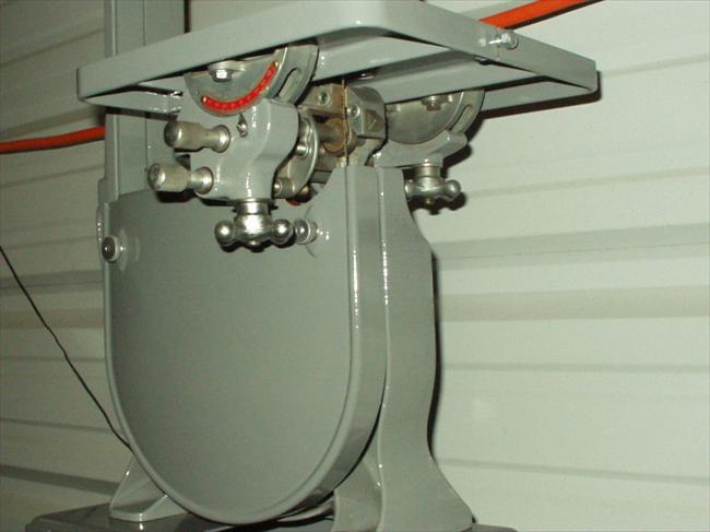

Lower under table view
C.Garrett

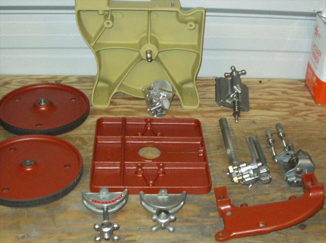

Primed parts in Eastwood Coreless and DuPont Variprime self-etching primer.
C.Garrett
