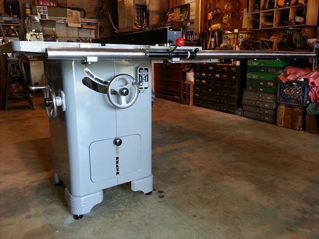

Bought on Craigslist for $75. Added a new 50" Vega fence and painted it the Delta color and added a red "Saturn" knob. Cabinet sound deadened. I laser etched a new dust door badge and Switch cover. Installed a fabricated dust collector that surrounds blade. Will run dust through tube between feet with quick release. Matched original paint under dust door badge which was still a deep gloss. Restored Tenoning jig on top.

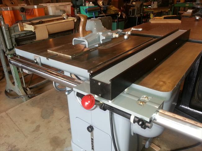

Tim George
vega with micro adjuster. Ugly Vega insert flipped over and stained Delta gray.

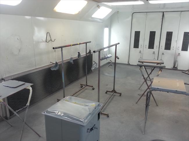

Tim George
Acrylic Enamel

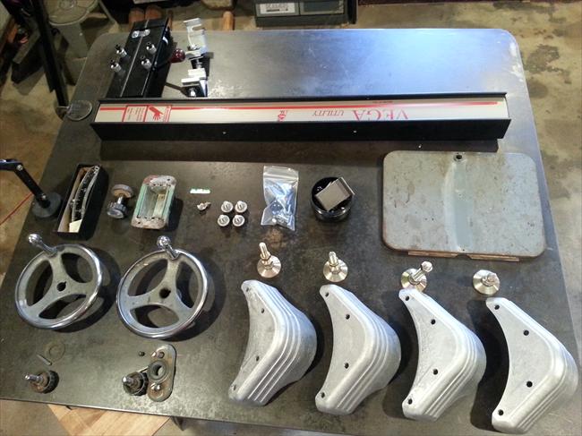

Tim George
Reproduction feet and adjusting feet.

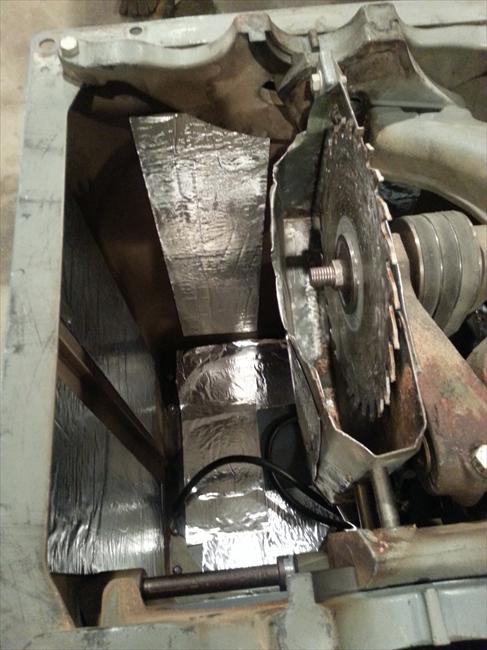

Tim George
Sound deadener. Gutter repair on 6" roll from Home Depot. $17. Dust collector is also pictured.
