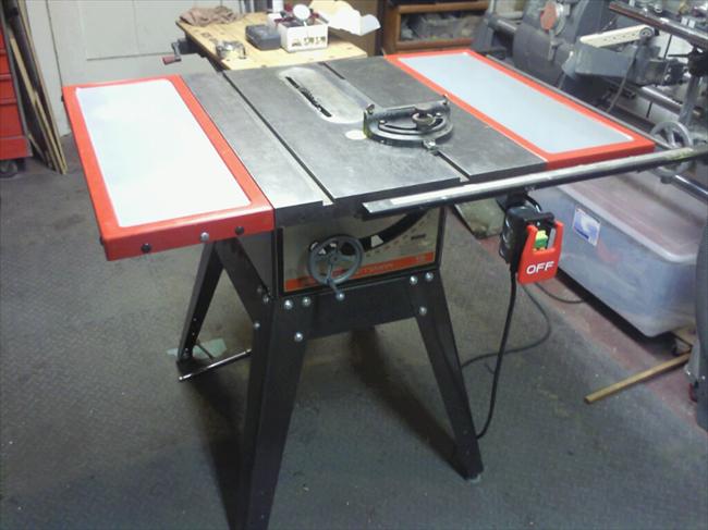

I found this saw in very rusty condition. The table still has numerous pits but it is clean and flat. I added a replacement motor, cleaned/painted, new bearings and segmented belt. Runs great. I also added a paddle switch and a new measuring tape. The wings sag a little so I need to work on that issue. I replaced all bolts and hardware. It is now sitting on a movable stand. I also added machined pulleys from Jerry Cole and In-Line Industries. I also have the saw set up system.
Comments: The finished saw

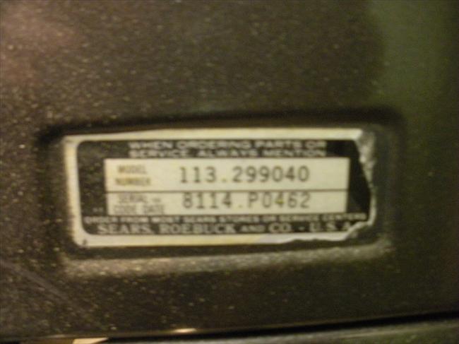

Comments: original tag
