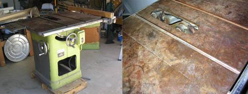

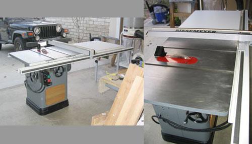

I purchased this 1966 Unisaw for $100 from the LA school district. I spent 4 months restoring it which included a new Baldor 3hp, Krylon paint, lots of new hardware, new arbor support etc. and loads of elbow grease. Added a few extras too. The restored image below shows a 90% restoration and since then a motor cover was added and all holes were covered. I made the front panel from oak and attached it with magnets. I've also connected this to my dust collector. This machine is an absolute joy to work with and will be passed down to my son. Called Delta shortly after purchase and they date it August '66.
Comments: 1 day after I aquired the machine.
Source: Shot by me.
Comments: After 4 months of restoring and adding the extension table and Biesemeyer 52" fence.
Source: Shot by me.
