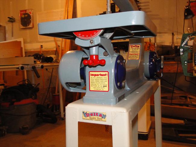

Reassembly nearly finished
self

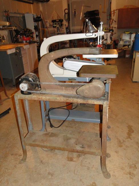

Next to a Model 1200 SS
Self

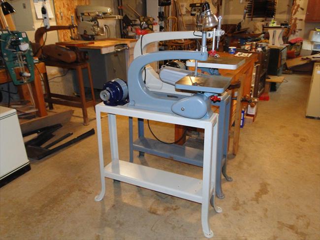

Under the table
Self

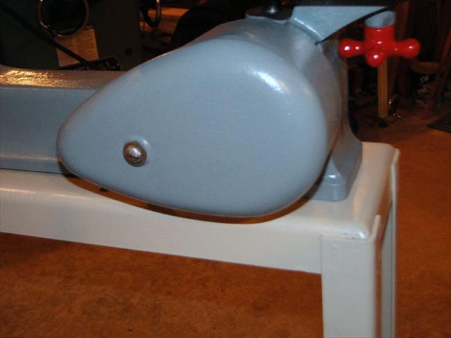

Smooth Belt Guard lacks center spine seen on the later HomeCraft saws
Self

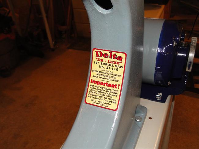

Synthetic 24-110 Label
Self

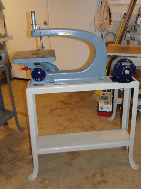

As Found with added G.E. motor
Self
