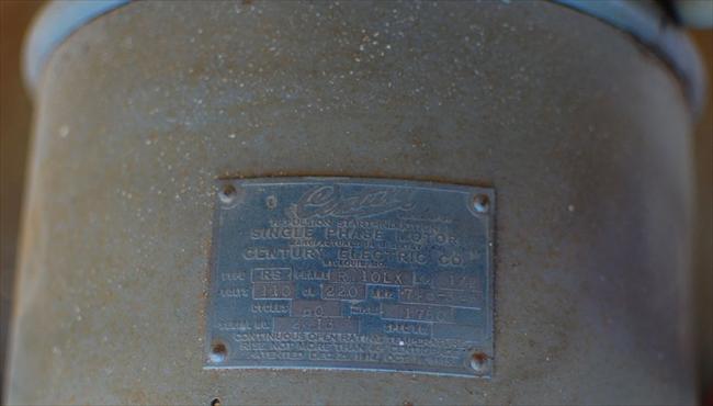

Motor running the unit is a Century repulsion-induction 1/2-HP motor of the same era.

Century 1/2-HP RI motor
