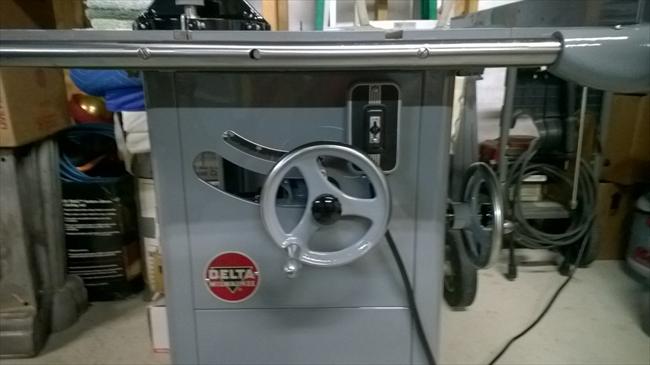

I do not own this machine. I did a complete tear down restoration for a customer friend of mine who lives in the Austin Texas area. I believe he bought this Unisaw Junior off a c'list ad out in Florida and picked it up while visiting family in that area. This saw was in excellent original condition when I got it in my shop in Central Texas and had not seen very much use over the years at all. It came with a 1/2-HP Delta brand motor that the owner upgraded to a 1-HP Rockwell Delta 3450 rpm motor. All parts are original except for the motor mounting bolts which are new.Both pulleys have been upgraded to balanced machined steel, new arbor bearings and a new Fenner link belt. This saw is running with a brand new 8" Forrest Woodworker II blade and cuts so smooth it's scary. The base cabinet was blasted down to bare metal, primed and all done in Awl Grip two part polyurethane paint system custom mixed in old school Delta gray color. This cabinet table saw is one HEAVY beast and the castings are off the charts beefy for just an 8 inch size machine.

Close up front shot
C.Garrett
