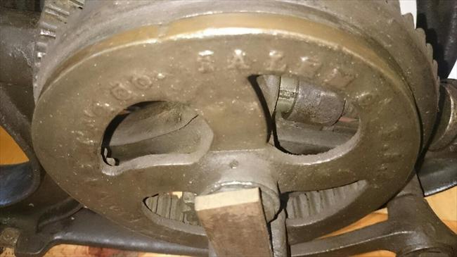

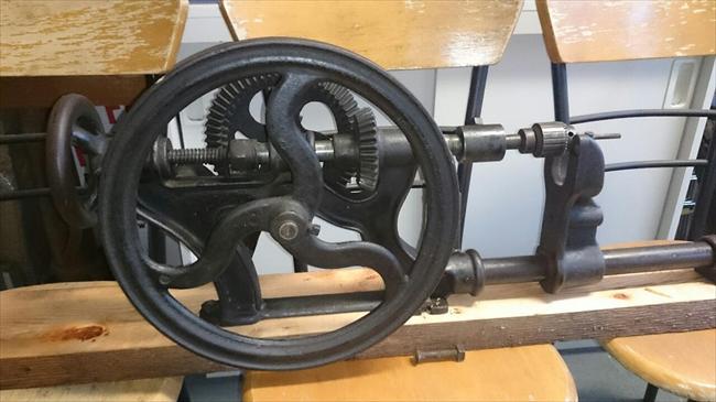

This is the early version with the 3 Spoke Fly Wheel, later on it changed to a 5 Spoke Flywheel. This drill shares many components with the No.1½. The main difference is the N0.1 is auto feed the No 1½ is not.
This drill is missing the original crank arm and table.
Over all Foot Print 9x16", Height 37", Table 6" Dia, Fly wheel 14½", weight 8- Pounds.
Spindle to table max 10½", Drills ¾" to centre of 12"
Takes ½" Shak Drill Bits

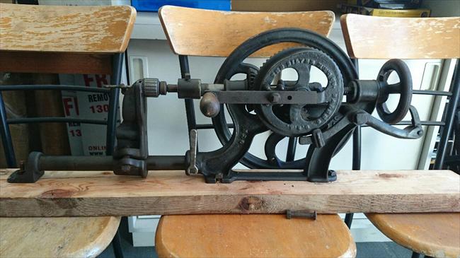

If you remove this boss for the auto feed the casting becomes a No.1½

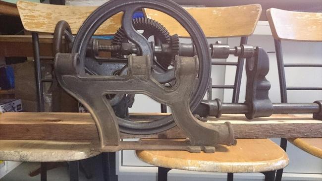

No.1 with No. 1½ body in front.

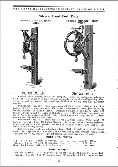

1911 Cat showing 3 Spokes
