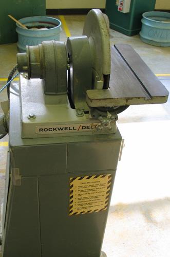

Machine Type: Sander
Machine Size: 12 in disk sander only modification
Submitted By: Robert M. Vaughan
Description/Model: 31-710 Belt-Disk sander modified
Date of Manufacturer: 1970's
Last Updated 9/26/2004 12:00:00 AM

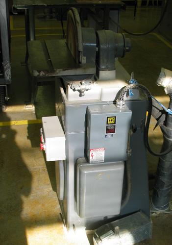

This is what one clever VA shop teacher did to keep a machine that would otherwise have been scrapped. The belt sanding portion had been damaged beyond reasonable repair, but the disk sanding portion was still good.
Comments: Left side of modified sander

Comments: Right side (lousy light) showing dust collection hookups
