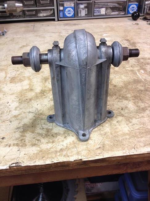

CDC model 888 polishing head.
Die-cast aluminum alloy body, pulley, flanges, & shaft collar.
Steel 5/8"ø x 7½" shaft reduced to ½"-20 threaded ends.
Overall height = 6-3/8"
Oilite bearings OD-3/4" ID- 5/8" Length-1" with spring loaded oil cups.
Pulley-2"ø
Flanges-1½"ø

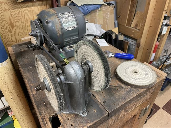

June 2021:
Set up for a buffing job.
Dunlap 1/3 HP 1750 RPM motor on Craftsman floating pivot mount, 4” pulley, 3Lx30" belt.
Comments: Front
Source: iPhone 4S camera-existing light

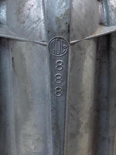

Comments: Logo & model number

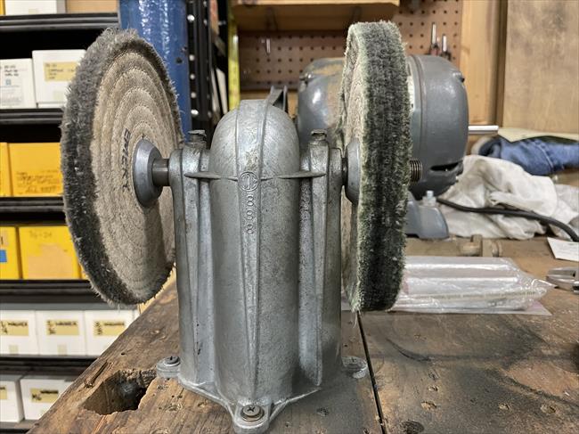

Comments: In service, running at 3500 rpm
Source: iPhone 12Pro camera-existing light
Comments: Collar opposite pulley mounted at shaft flat-pulley self centers while running.
Comments: A high quality inexpensive polishing head.
