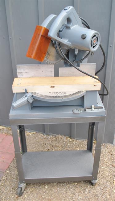

Bought at a Farm Estate Sale, and was all there and worked, but needed some TLC, which I gave it. New paint, and wood bases. This is a 9 inch Rockwell miter saw, very easy to use and adjust for cutting. It is a cogged belt drive, Belt part # 49-083, and cost between $29 and $52 each of what I found. Ebay or Google belt part #. Believe the Delta belt is the same number. It's a nice little compact saw for a small workshop that has little room for bigger tools. June 3, 2020, Question by Barbara, Does the miter saw close down, for ease of carrying or not ?? There seems to be a little lever on the back of the machine but when I move it, it does nothing..what is the lever for if not to lock the blade head down. It's been a while since I worked on the saw and I don't have it anymore. She requested and Delta delivered to her, an 2-PDF files of the Owners Manual and Parts& Diagram and List and the Owners Manual showed the "lock down" Pin/Handle, and she got the lock down to work on her saw. Thanks to Delta/Rockwell. Mystery solved. https://www.ereplacementparts.com/delta-34010-type-fd6575-miter-box-parts-c-3275_3503_14223.html. 06-13-2020 Here is a LINK to the Instruction Manual and Parts Diagram and Parts List. they sent her. Here's the LINK:
http://www.vintagemachinery.org/pubs/detail.aspx?id=25344.
Thanks to her, now everyone can enjoy these items.
Rockwell Saw as Bought at Farm Estate Sale
My picture Canon PowerShot A 620
Paint & Facelift, New wood.
