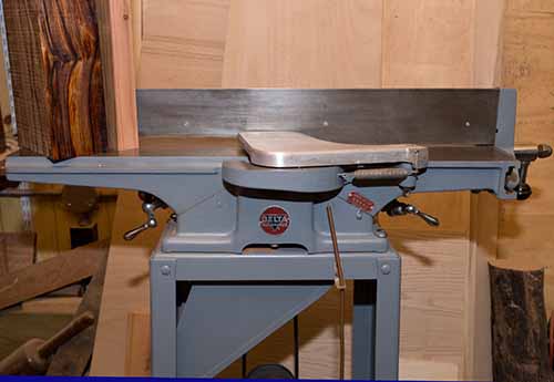

I purchased this machine in November 2004 in San Francisco. The last owner was not using the machine. It works well, but one of the pulleys wobbles and needs to be replaced. The motor appears to be a replacement, 3/4 hp, 3450, generating the wrong speed for the cutting head. I intend to reverse the pulleys to reduce the head speed. I have already removed the worst rust and plan to do some repainting. I expect this machine to get used on a regular basis.
After restoration - my first. The two boards on end were jointed, the cocobolo is particulary dense.
