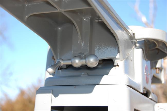

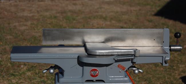

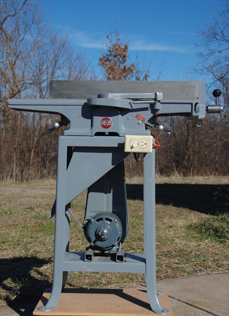

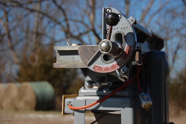

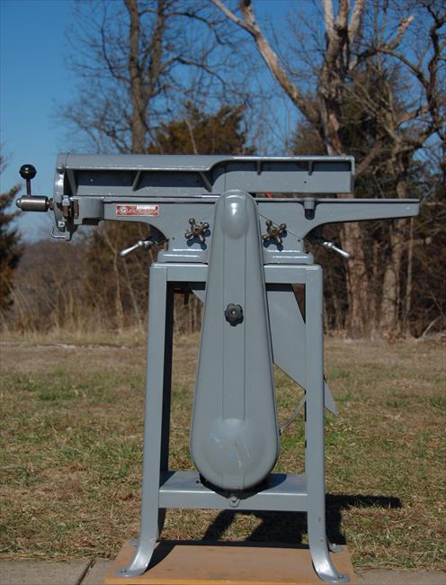

I acquired this jointer via OWWM Forum. It was transported to me in MO from CA through the Rucker system by way of 2015 Arnfest. It came on a cast iron stand, which I used on another jointer. I'm not certain this stand is Delta. I'm told it may be a Walker-Turner stand. The jointer was in pretty neglected condition with very rusty table tops, fence, and cutter head. I used electrolysis to remove that, cleaned everything, replaced missing gib screws, & primed, painted, and waxed it. The table locking knobs are not period correct, but that's what it came with. This jointer is extra for me, so it will probably go to a different home soon.
1953 Delta Rockwell 6" Jointer after restoration, front
S.V.
1953 Delta Rockwell 6" Jointer after restoration, rear
S.V.
1953 Delta Rockwell 6" Jointer after restoration, under outfeed table
S.V.
1953 Delta Rockwell 6" Jointer after restoration, fence segment

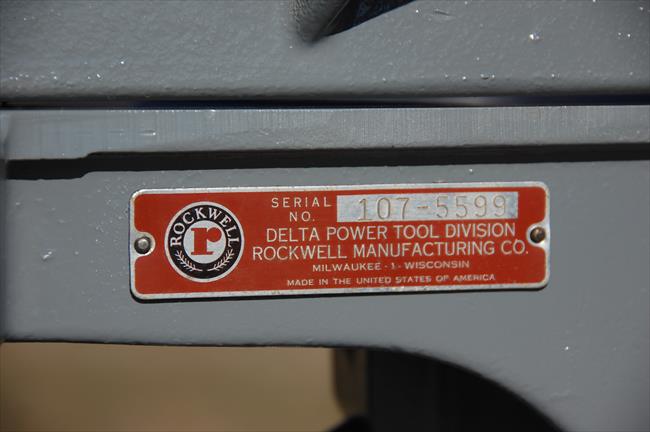

1953 Delta Rockwell 6" Jointer after restoration, serial tag
